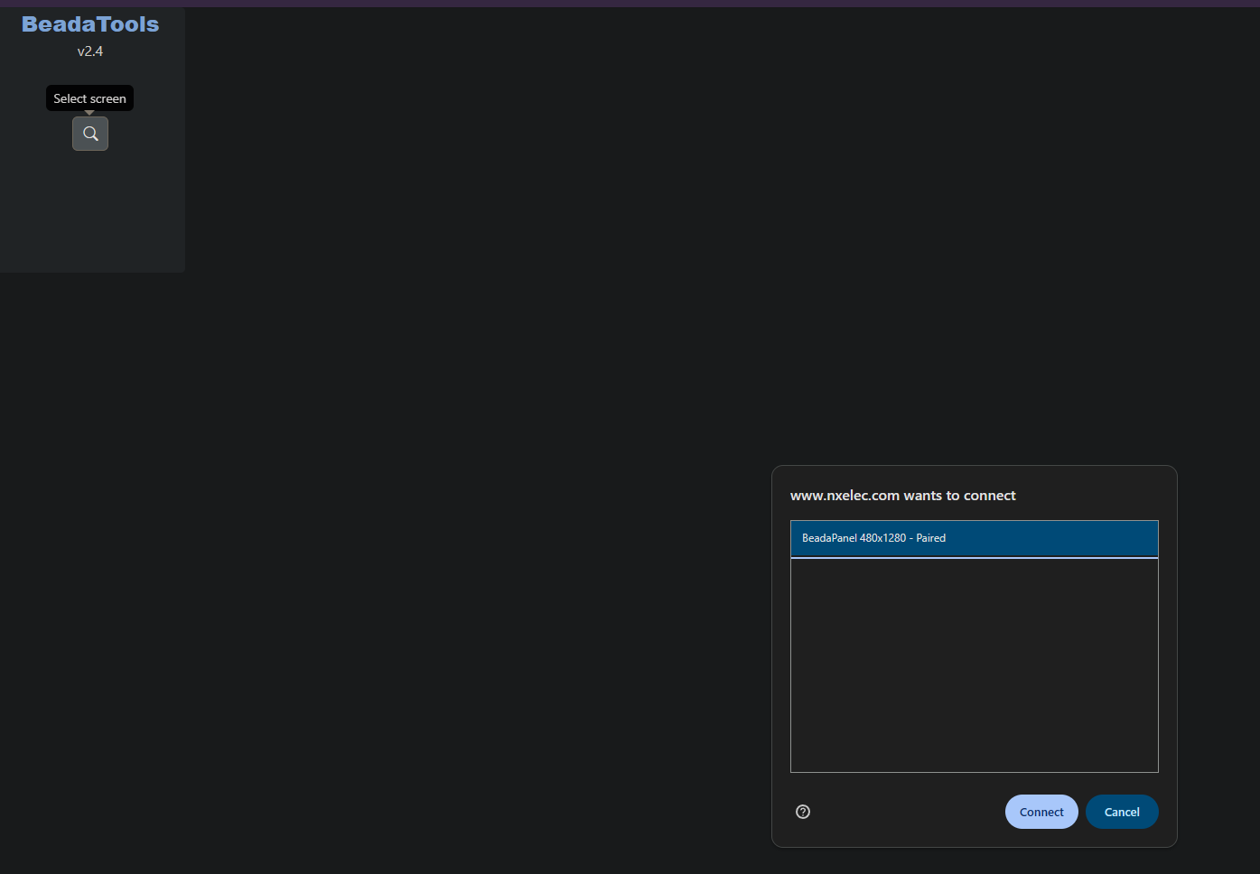

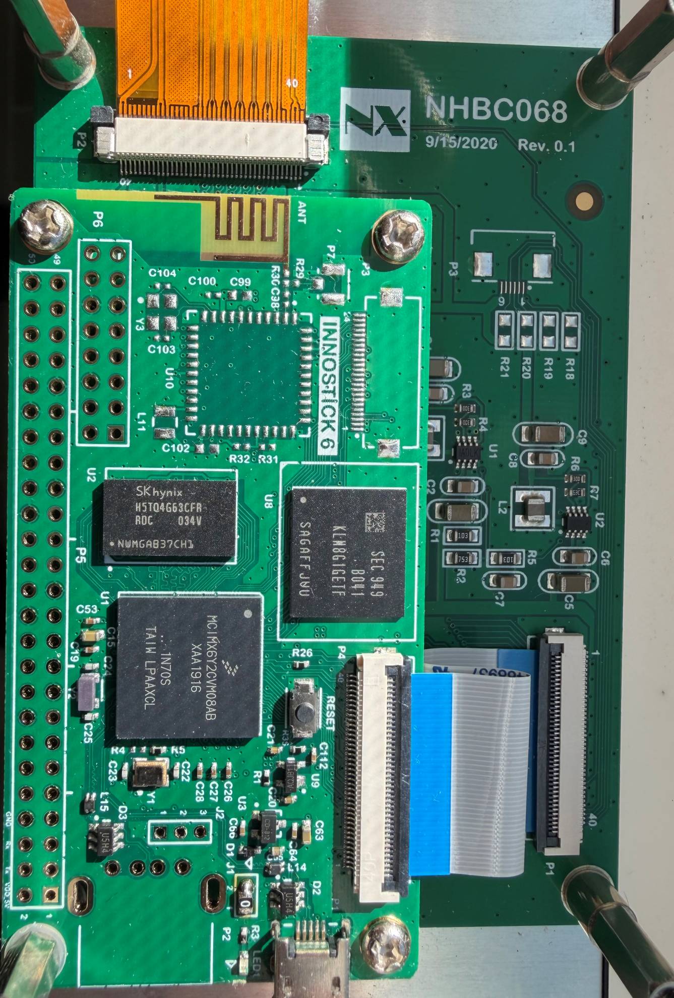

Hi... need some help with my Baada panel. In short, regardless how many times I reflash my panel, beada service tool senses my panel as a Model 5 instead of 6 but yet the resolution is noted properly. With that said, it leads to Win11 also detecting the panel as a Model 5 and subsequent software (AIDA, InfoPanel) get the Model 5 and its associate resolutions (which do not match my actual screen).
I attached some images that I hope help. Any assistance is very appreciated.

- IMG_0082b.jpg (380.84 KiB) Viewed 29495 times
- Service Tool 1.png (22.03 KiB) Viewed 29495 times
- Service Tool 2.png (11.32 KiB) Viewed 29495 times

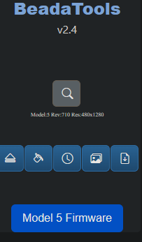

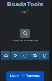

It shows 7.10 after flashing. I am able to upgrade to 7.18 but still notes as model 5 (sent in previous screenshot).
Thanks!
Not sure if relevant, in win11 device manager the device Hardware Ids are:
USB\VID_4E58&PID_1001&REV_0718
Based on quick research I believe the NXElec is suppose to be: VID_1FFB
Thanks!

- Beada 710.png (11.14 KiB) Viewed 29479 times
Re: Beada 6.8 in weird issue
Looks like your environment was polluted seriously by some mis-operations and a normal reset can not recover it. We will provide a whole eMMC image to let you rewrite the device. Will let you know soon.tuftybruno wrote: ↑Thu Nov 13, 2025 12:18 pmIt shows 7.10 after flashing. I am able to upgrade to 7.18 but still notes as model 5 (sent in previous screenshot).
