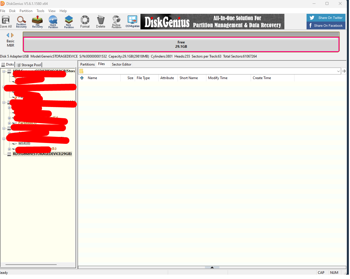

hi I am sorry, want I want to restore the `.pmf` from the google drive that you PM, somehow all the partition erased, can you help me to restore them first?
for esky-sh.png (124.85 KiB) Viewed 107745 times

Weird. Had not you ever been able to restore EXT4 partition successfully in early of this thread? And so I assumed you have ability to restore EXT4 by yourself.
https://esky-sh.com/bbs/viewtopic.php?f ... t=10#p3599
