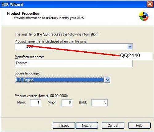

Platform -> SDK -> New SDK to start SDK Wizard
NEXT---->
Type in QQ2440:
NEXT---->

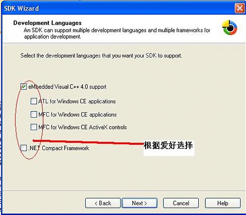

Platform -> SDK -> Configure SDK
NEXT---->Finish

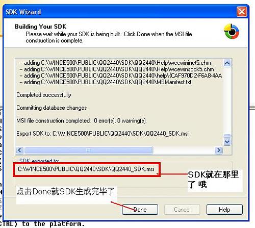

Platform -> SDK -> Build SDK
