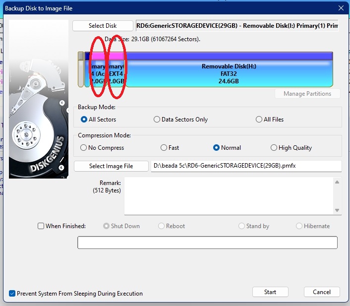

Looks like file systems on 2 EXT4 partitions were corrupted. We do not know the reason why corrupt yet. But I will PM you a url for partition backup file in DiskGenius format, you can download and use DiskGenius to recover them.
beada5c partition.jpg (104.62 KiB) Viewed 110410 times
Hi I received your message, all is good. I dont know too what is the reason, but may I know how to update firmware so I can use Beada tools? I want to update some configuration. And also, is it possible for me to buy new TF/SD card then reformat it? I afraid my card is corrupted because of the hardware itself is failing.
