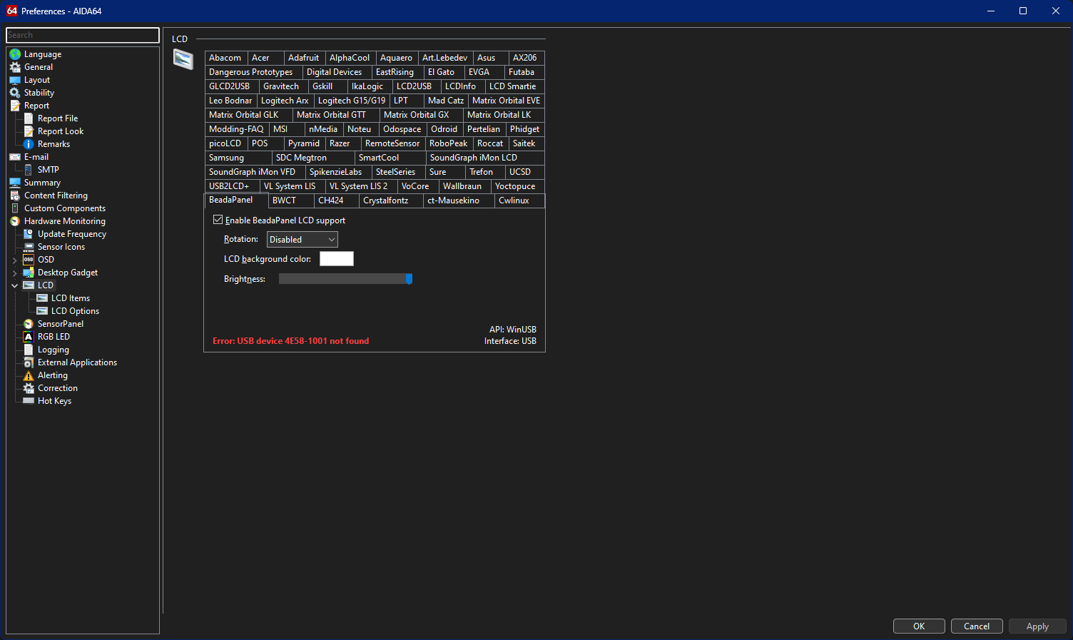

However, I noticed the blue LED blinking 3 times, and the screen did not show up in Windows Device Manager. And in Aida64, it's showing this message: I tried on a a different PC, but sadly it has the same result: the screen is black with the backlight turned on.

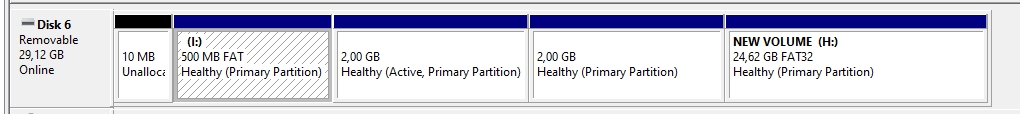

I also noticed when my PC turned off/it was not connected to Aida64, It was not showing the photo gallery anymore, so I took the Micro SD card, put it into my SD card reader, and found one of the partitions cant be open, its the partition where usually we put the image/photo. Then I formatted that one and put a photo there.

Btw, I also noticed that in one of the partitions inside the micro SD card is like this (I not formatted this partition I just left it).
just an additional information that may help

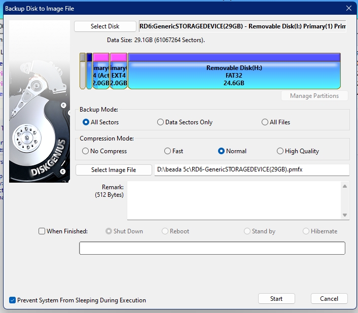

Hi, I am ok to do it, but may I know what you mean by backup whole TF card image?esky-sh wrote: ↑Tue Aug 20, 2024 9:17 pmWe are sorry for the issue you met. We will quickly going through some steps for 100% ensure it is belong to hardware or software issue.
Could you mind backup a whole TF card image to a image file, compress it and upload it somewhere on cloud to let our support download and analysis in our lab? You can use tools like Diskgenius or Win32DiskImager to do this job.
are you referring to this entire disk partitions ?

also, can help to confirm if what I select in here is correct?
thanks.

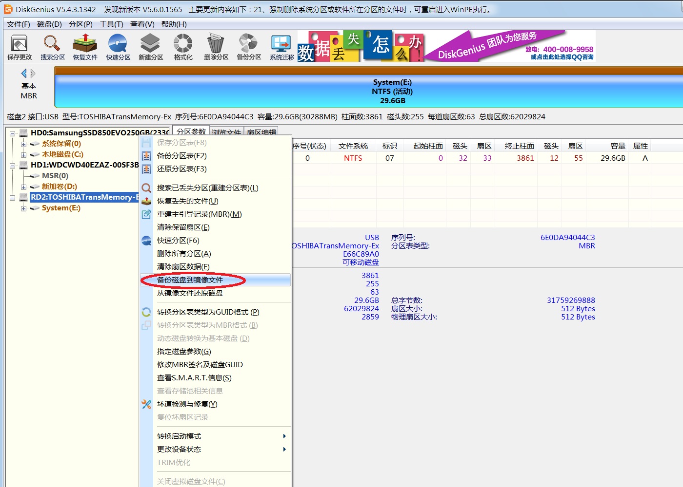

1. Right click on the disk

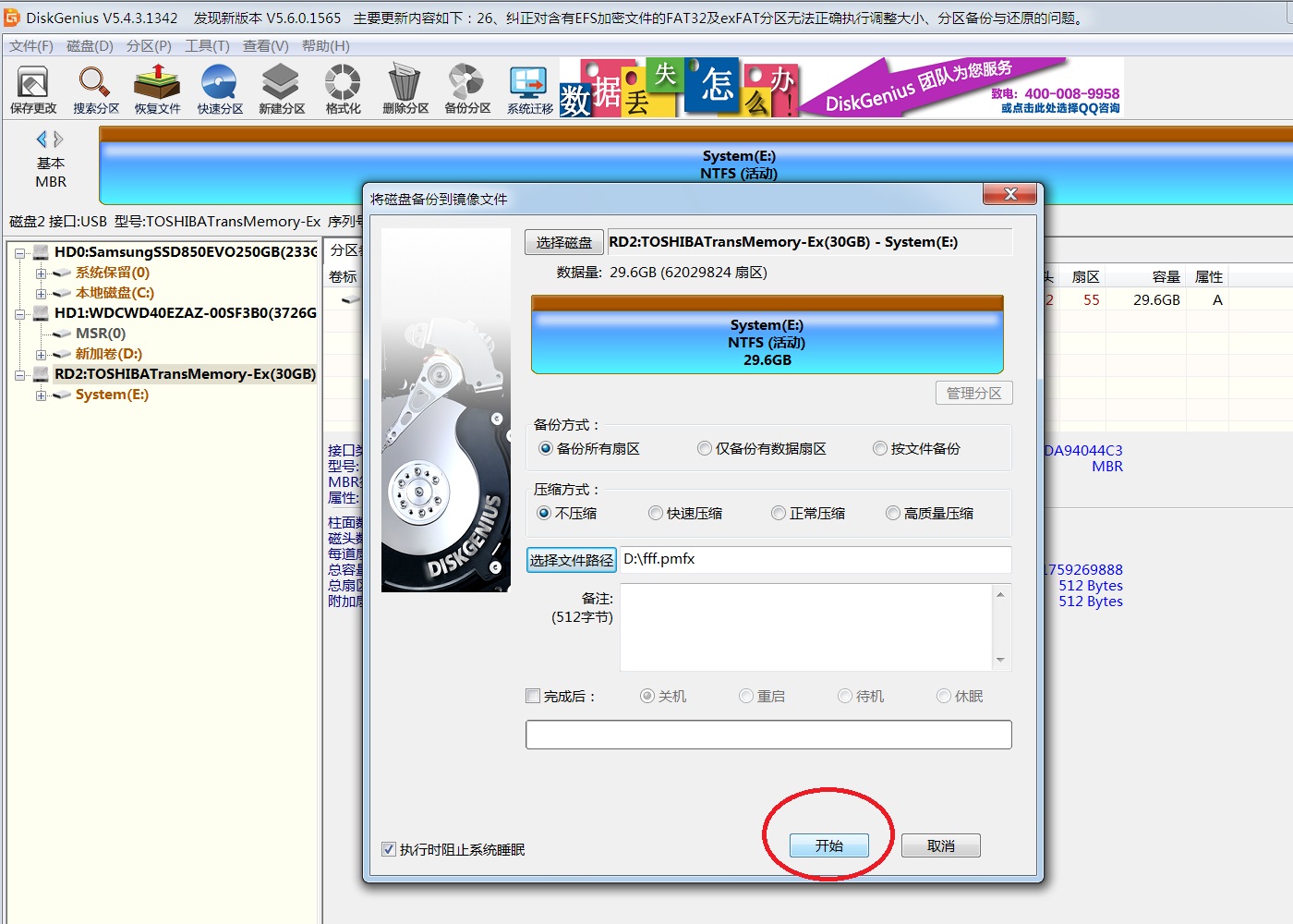

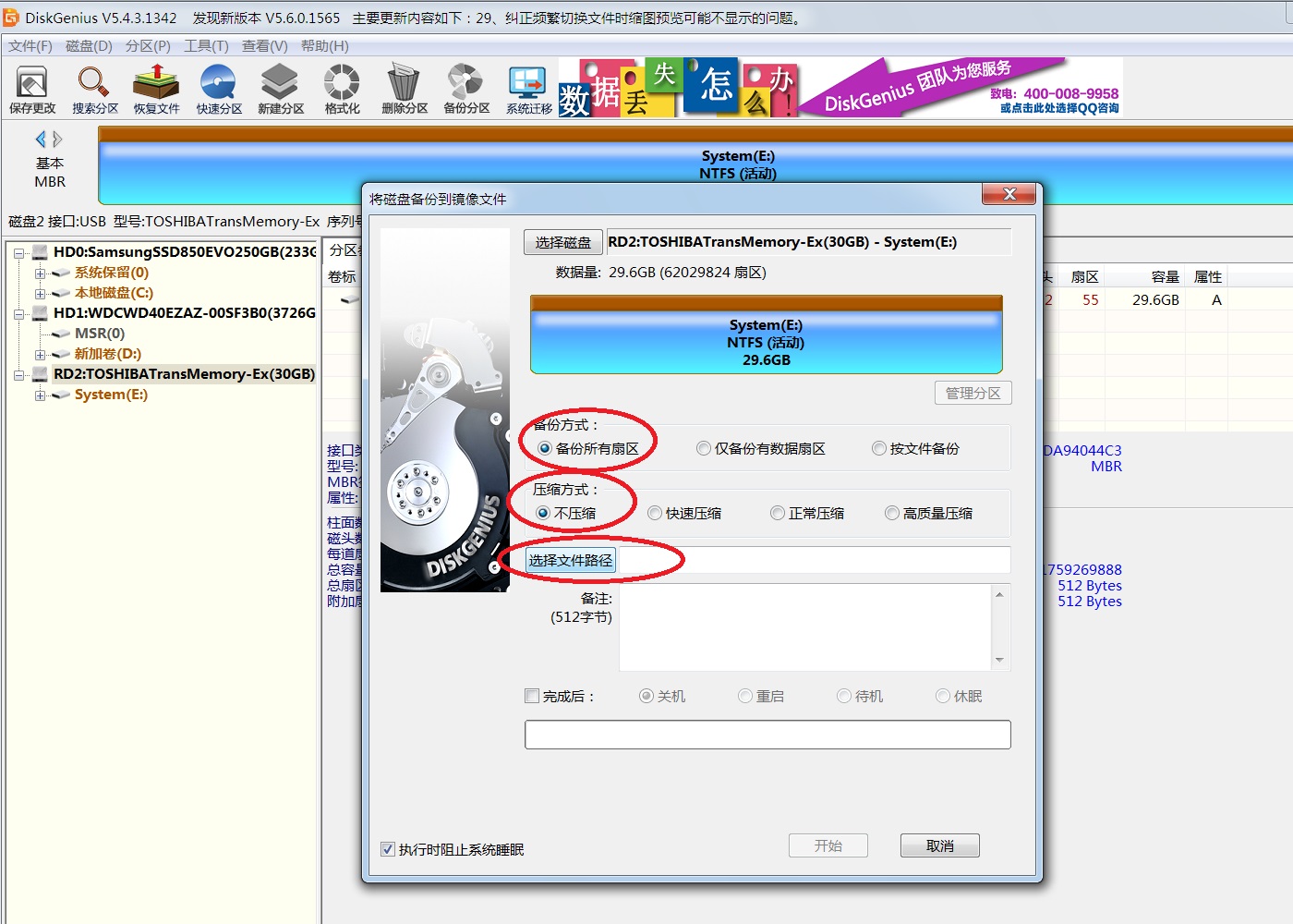

2. Backup all sectors / no compress
Re: Need help on BeadaPanel 5C
3. Start backup.
