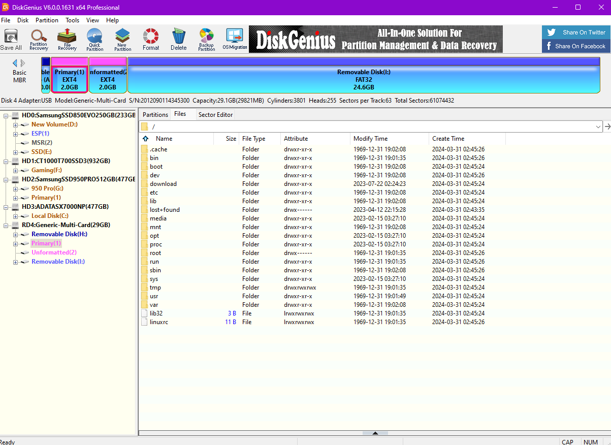

I followed those instructions but I ended up having a 2nd drive letter under FAT32 so I deleted it and now I have this. Still doesn't seem to boot the screen up. How would I add the correct firmware to get screen booting up again?

It also seems like since doing this the blue light no longer flickers when I have the Beadapanel plugged into USB
And it looks like the EXT4 partitions are missing whatever firmware or boot files were in there. IDK if that is related to why its LED isnt coming on and why previously when it was coming on, the screen was just flashing with backlight on

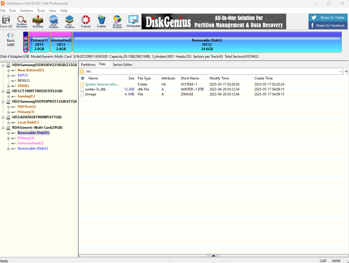

Ok I went through the steps to create the partition and hit no to formatting the FAT32 drive (it still seems to have assigned a drive letter automatically).esky-sh wrote: ↑Sat May 17, 2025 2:29 amAfter FAT32 partition creating,then you can follow this procedure https://www.esky-sh.com/bbs/viewtopic.p ... 1120#p3946
I have the two files on the FAT16 partition also which i attached a screenshot of.
The Beadapanel seems to have the files on it now but I dont know if I'm missing any other files because I dont see a link I can access to download files if I need to restore an image for the EXT4 partitions. Unless that isnt necessary.

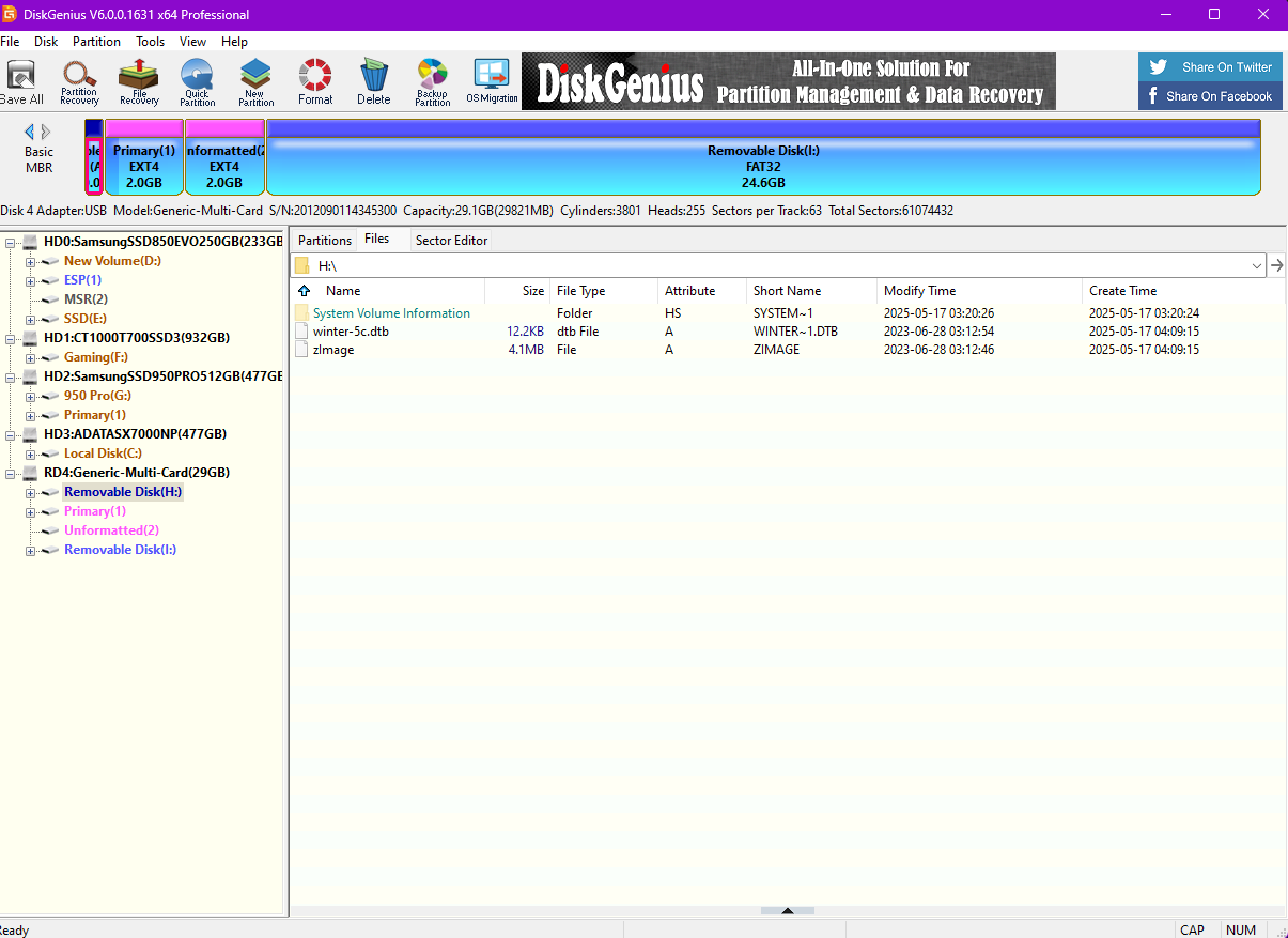

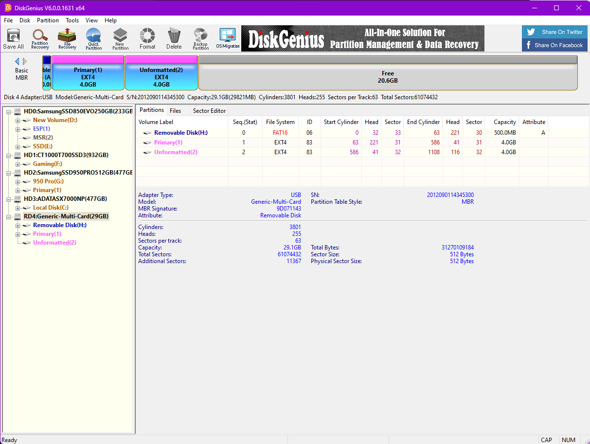

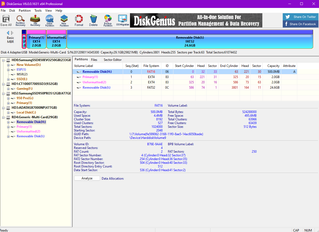

Yes I believe so, I'll attach a screenshot of the FAT16 partition files you mentioned, what my partitions look like, and the Primary EXT4 partition which has the .tar files inside of it.
But those 2 files are in the FAT16 partition as you said, FAT32 is empty aside from the system volume information hidden folder. And I dont see the OneDrive link anymore but let me know if those files are not the right ones, they seem to match so I believe its correct but I dont know if I used the same OneDrive link you mentioned since I found the link in another thread but it was a folder for a winter 812 that had those files and said it was for the 5C boot.. so I believe they are the correct files.
- Screenshot 2025-05-17 094814.png (192.53 KiB) Viewed 31598 times
- Screenshot 2025-05-17 094748.png (182.37 KiB) Viewed 31598 times
- Screenshot 2025-05-17 094738.png (151.92 KiB) Viewed 31598 times

I also dont know if this is an issue but the FAT16 partition shows the text for file system in red letters but the other partitions are in black text for file system, not sure if this is a bad thing.
