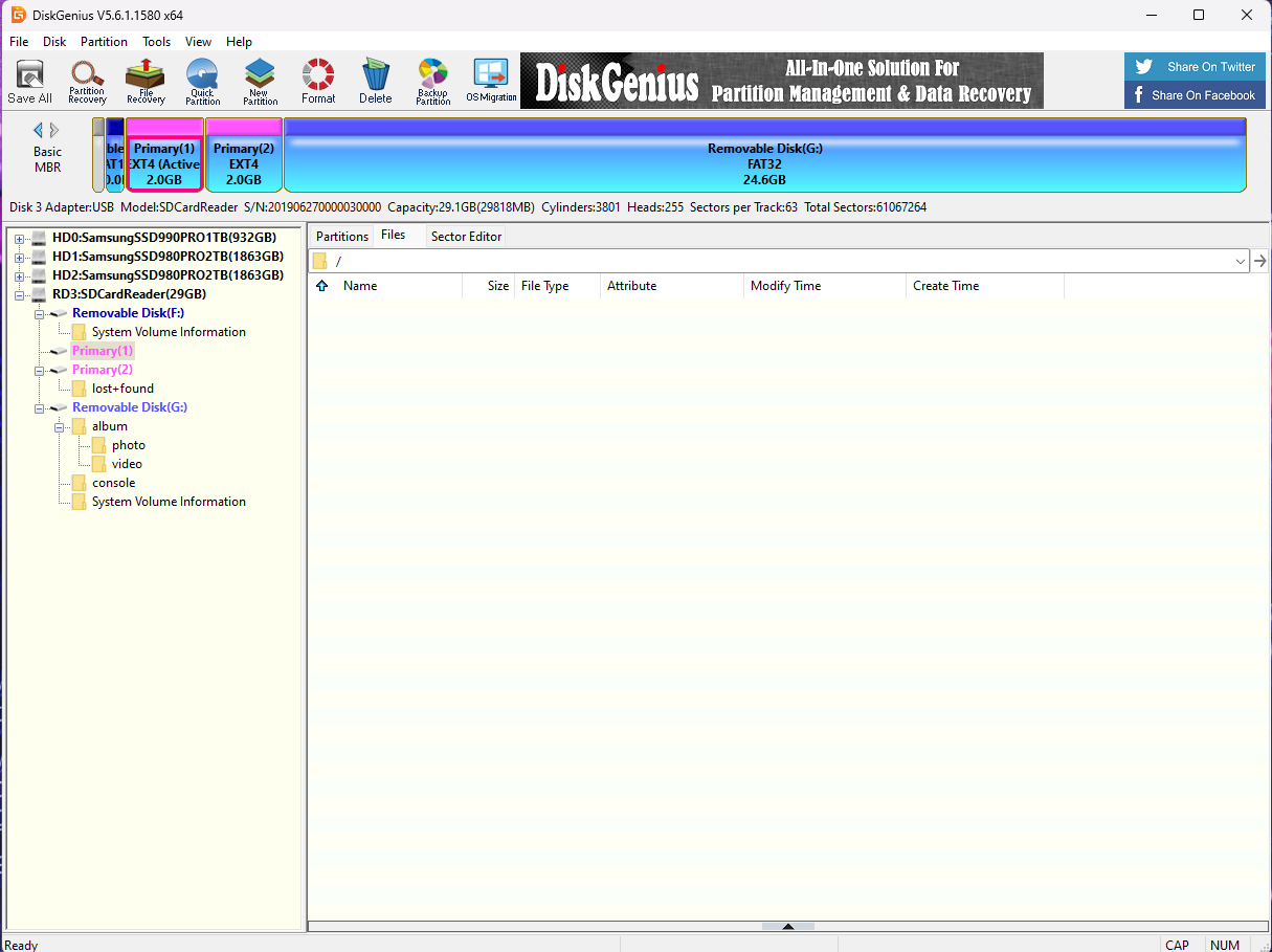

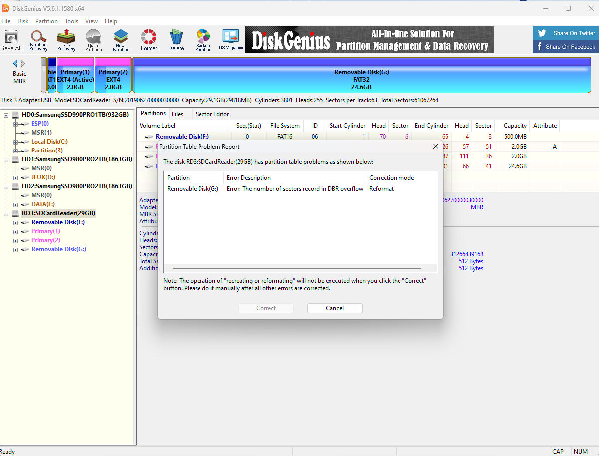

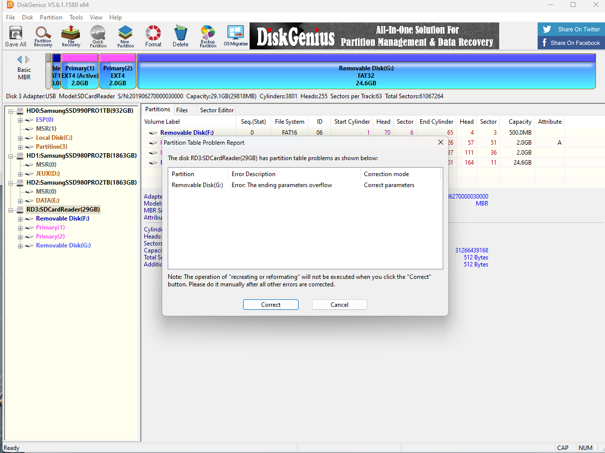

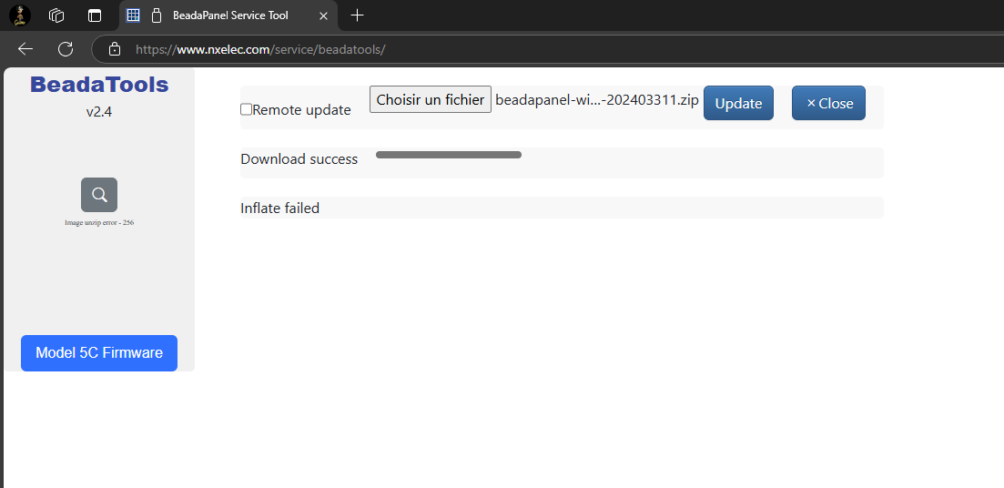

Hello,
Recently, I have encountered a lot of problems with my BeadaPanel 5C (unknown device, AIDA64 freeze at launch, LCD init error in AIDA64 ...)
I tried to flash the firmware with BeadaTools, I get an error "Inflate failed".
After reading several forum topics, I installed DiskGenius which indicated 2 problems with the partition table. The software was able to correct this errors but this caused a formatting of 2 partitions (Linux EXT4 & FAT32 Media Storage)
I was able to restore the FAT32 partition but unable to restore the firmware on the EXT4 partition.
The FAT16 partition has not been modified, normally it is OK for this one.
I saw that it was possible to restore the firmware partition with a DiskGenius backup (PMF file), do you have a link to recover this image ?
Would it be possible to also have the rest of the files needed to restore an SD card ? In case it starts again or if I need to change SD Card in the future.
Thank you,
Best regards,

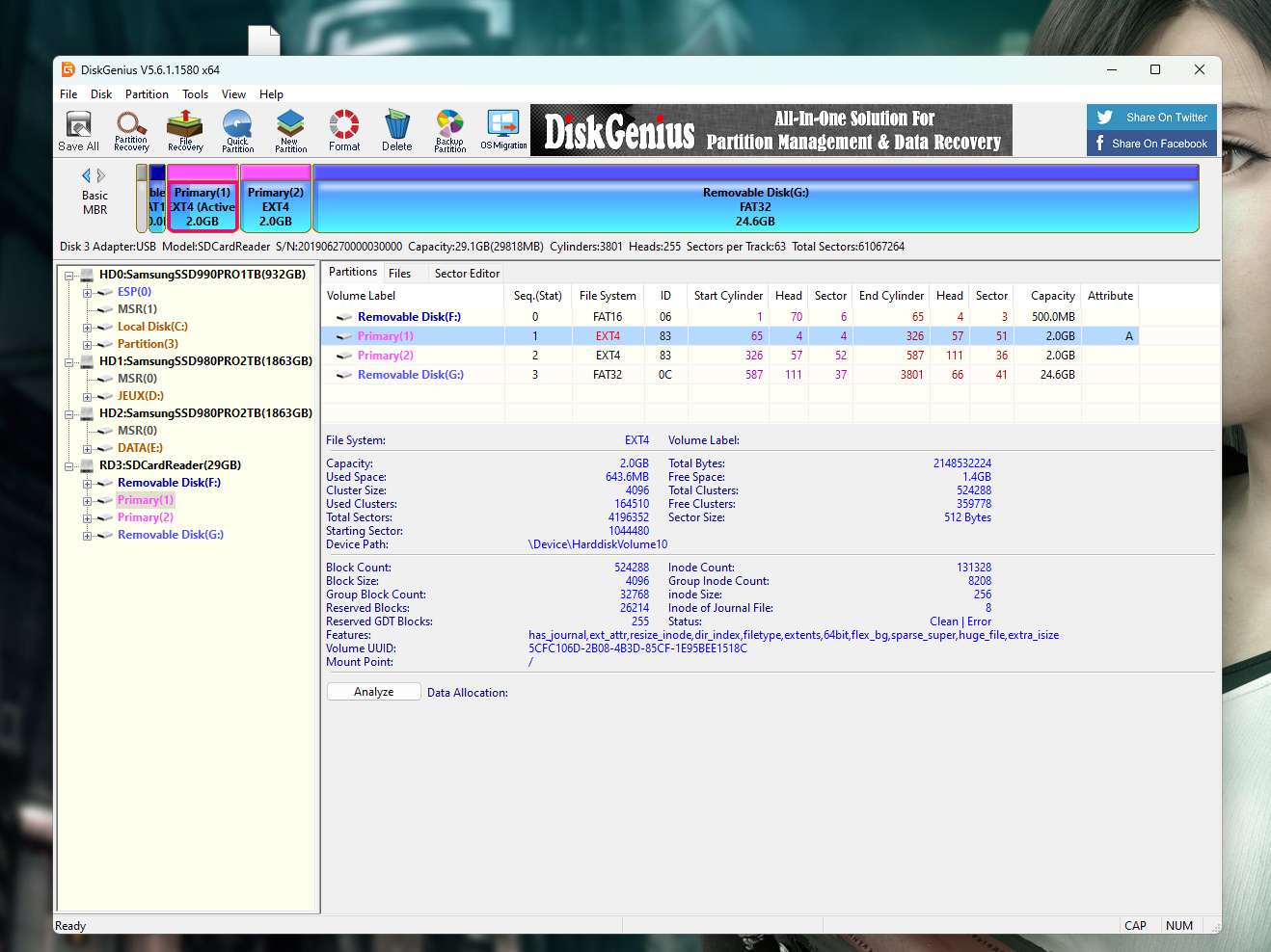

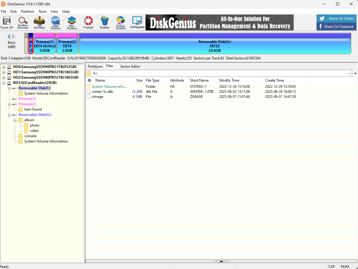

Here is the current content of the partitions
- EXT4_1.png (149.59 KiB) Viewed 148603 times
- FAT16.png (148.73 KiB) Viewed 148603 times

Re: [5C] SD Card Partitions Problem
You can follow this link to recover 2 ext4 partitions on the TF card.viewtopic.php?f=30&t=991&start=10#p3597
The screen is working again after restoring the PMF file. Thank you for your help.

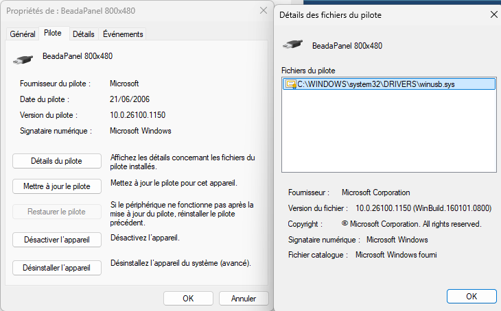

I was referring to the Device Manager, furthermore, Windows does indeed list a driver for the screen...
I will check with AIDA about my problems, thank you for your help
This is WinUSB driver which came with your Windows installation. I do not think you have any options to substitute or re-install it. BeadaPanel had been working with this native MS driver since it born in early 2019.
