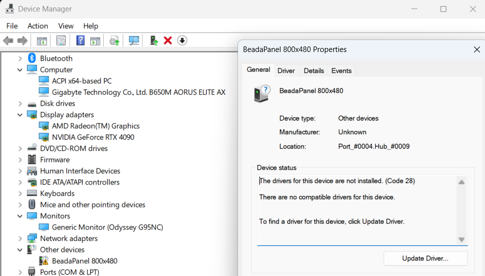

thanks! The troubleshooting has worked somewhat. I recovered the ext4 partition with the .pmf file, and put the .dtb and zimage in the E:. The screen does show the videos, but still doesn't show up in AIDA64. In Device manager, it shows that there is no driver installed...

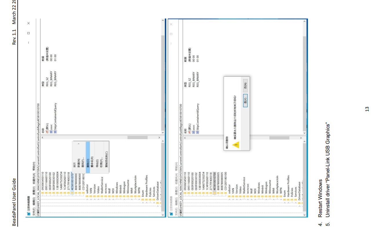

If you had already installed Windows secondary monitor driver on your Windows host, then please uninstall it before you try to reconnect with AIDA64. These words are stated in BeadaPanel User Manual.
屏幕截图 2025-07-21 163737.png (243.16 KiB) Viewed 36460 times

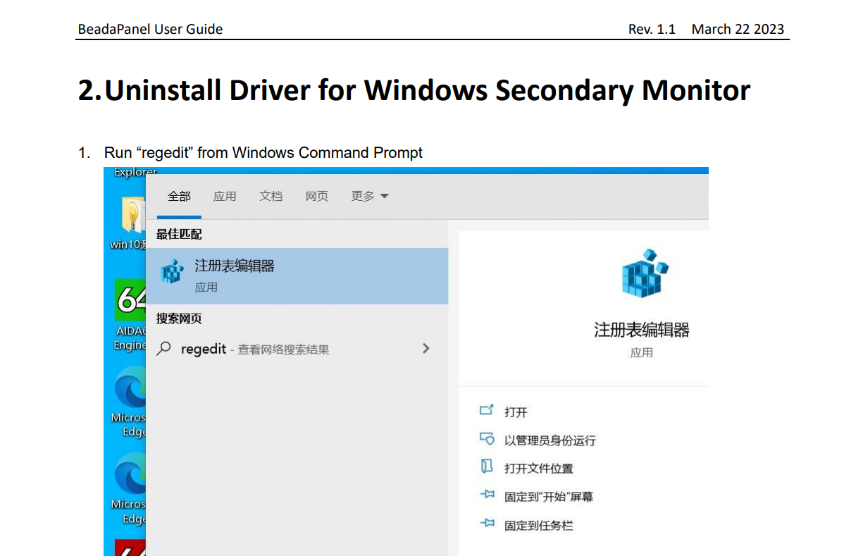

屏幕截图 2025-07-22 080243.png (334.91 KiB) Viewed 36458 times
delete this registry folder.

yep matched the first couple of hex and deleted 2 folders, and it works now, thank you!
