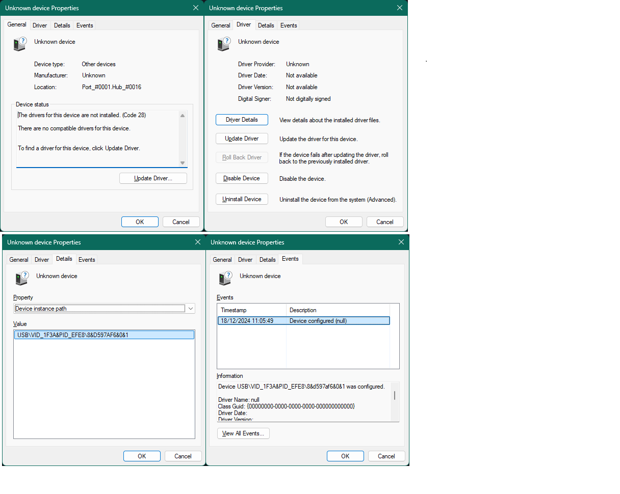

please open your Windows device manger and take a screenshot of this 'unknown device'
sorry I just have time now, this is what shown up in device manager
device unknown in device manager.png (58.18 KiB) Viewed 157467 times
