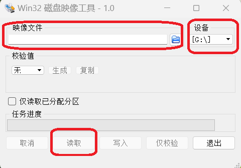

屏幕截图 2024-05-03 111708.png (11.42 KiB) Viewed 60786 times
You can input image file name and location in the left dropbox, and then choose drive letter for the TF card on right.
Finally you can click 'Read' button to read the content of TF card to the local file.
PM me link as soon as your upload done. Thanks

Thu May 02, 2024 7:22 pm
Okay... that part I know all how to do...
I thought there was going to be a way to make the drive visible in Windows as it is right now (kind of like how using BeadaTools11 to disconnect the screen, so that I can add files).
So I need to actually take it apart, pull out the card, and read the drive manually... got it... will send you a PM when done.
