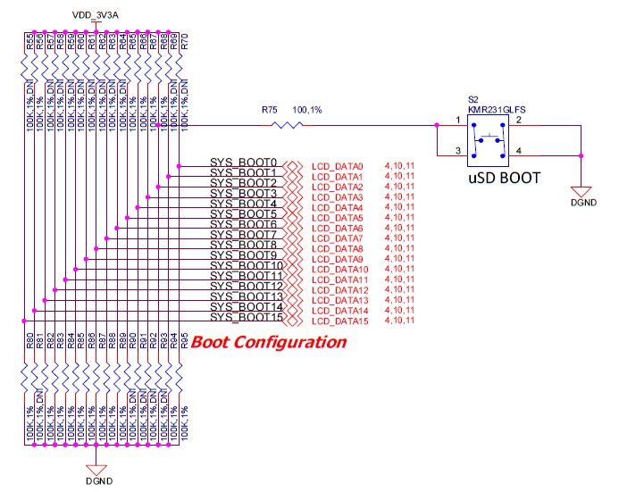

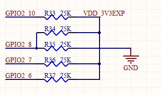

Post by esky-sh » Thu Jul 18, 2013 5:19 am
Beaglebone sysboot config
Beaglebone Black sysboot config
NBD02 boot config
