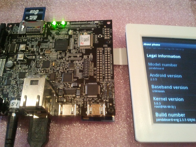

BTW, I am glad to hear that image can work with Pandaboard ES either, can you share us with some photos for those amazing stuff?

Of course. I only have my cell phone here, so the it isn't the best quality.
Alex

- pandaboard_es_beadaframe.jpg (155.5 KiB) Viewed 37863 times
