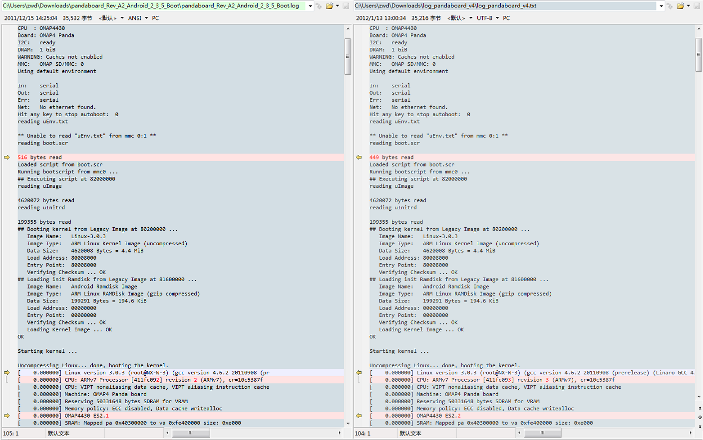

So, the screen still stays white forever. Please find the log attached.

Re: Problem with 7" Display and Pandaboard A4
you were using a different boot.scr file other than from out ftp.
It seems that there is a problem using the script to create the image. I face the same problem like the guy in the other thread.
I mean, i just downloaded the files, executed the script and I ended up with that sd card.
I have too look whats going on here, maybe it's a problem with VMware (I use it to boot to linux and mount/flash the sd card).
Ok guys, it's working now. I inserted the sd card again and manually extracted/copied the boot.scr file to the boot drive.
It also works with the ES version of pandaboard.
