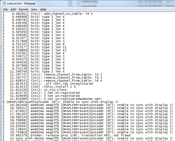

Hello,
We have been testing the 7'' TFT LCD with the Linaro 2.3.5 version
(internal version of Linaro is 11.09) and we still cannot make the display
work properly. We have tried with both 0 and 33 ohms resistors and we use
Revision A3 of the Panda Board.
Please find attached the log of messages
at boot time. I hope it can help you diagnose why we still have that issue.
There is a Display error message appearing at the end.
Francois

Re: 7'' LCD not working on PandaBoard with Linaro 2.3.5
The software image on FTP works with Pandaboard Rev A2 well. I had a quick check with pandaboard.org and found those comments:
** Rev A3 is the same as A2 except it has: OMAP4430 ES2.2 silicon version
http://www.pandaboard.org/content/resources/references
Could you tell us more details for the issues you were facing:
1. What issues you met as 'not work' in your statement?
Some technical words make sense for investigation should like "serial console freeze", "system halt", "LCD screen stay white", "LCD screen stay black", etc.
2. When you upload log, a complete log message start from reboot will be more helpful for our analysis.
You can either type "dmesg -n8 " to list these messages.
3. Have you had a test with linaro official 11.09 release with a DVI monitor?
This will be very helpful for problem isolation.

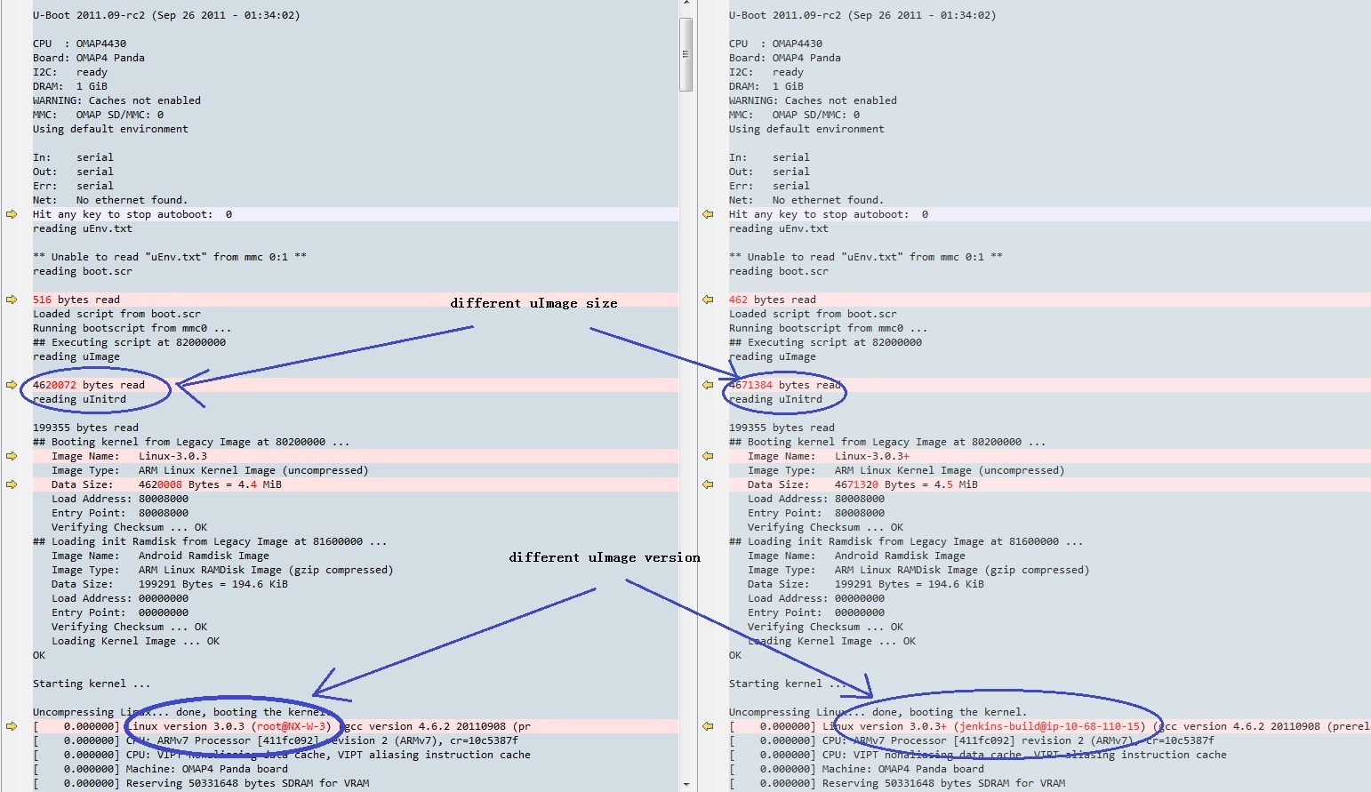

thanks for the detailed info. we can start troubleshooting now.
1. the log you attached tells us that you are using a uImage from linaro 11.09 'official' release.
Why don't you use the uImage file on FTP that customerized for our beada frame? 2. you do not need to remove resistors bank B and C on front of pandaboard, when you try to test LCD i/f on back of board.
OMAP4430 DSS signals can be routed to 2 destinations(dvi and lcd) simultaneously, actually this is what we were doing in our lab.

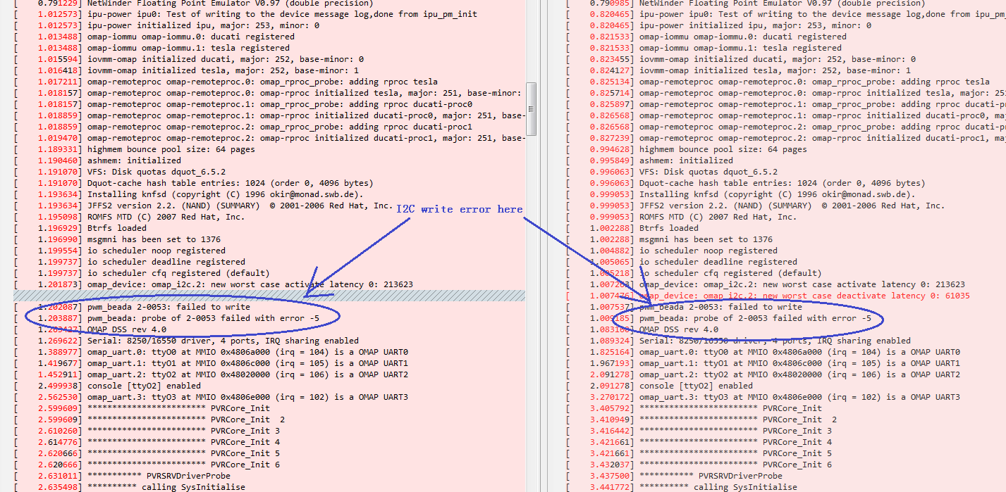

Hi,
We have continued the debugging of the LCD with the image and boot provided on your FTP site. We have noticed a change, the screen becomes blank after a few seconds. However, it never shows up Android booting. I have attached the new log, and noticed a diffrence with your log.
You have line: [ 1.076629] pwm_beada 2-0053: Rev.0 Backlight
In our case we have:
[ 1.202087] pwm_beada 2-0053: failed to write
[ 1.203887] pwm_beada: probe of 2-0053 failed with error -5
Could it be the reason of our problem ? Can we send you back the LCD unit for further investigation ?
Thank you!
Thank you!

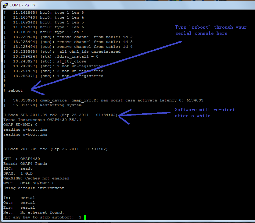

Great catch! Thanks for your continous efforts on troubleshooting and leading us arrive the solution.
There is an known issue in our early pandaboard customers before December, 'I2C write error, caused by NBD01 3.3v setup too later'
Here are our suggestions:
1. To confirm with this issue, please type reboot command on your serial console when android boot up. Then you will find I2C wirte error disappear and LCD backlight start to work.
2. For a final solution, you may need to change C3 on NBD01 board from 22uF to 10uF, this will allow a shorter power setup time for I2C work between pandaboard and NBD01.
3. If you can not find appropriate capcitor on your hand, just leave C3 blank.
Sorry for inconvenice caused by this issue.
I have been able to reboot the panda board but it does not help, the screen stays blank. What do you suggest ? Can we send it back to you ?
