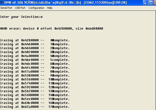

I started from NOR
1.I have chosen the command [f] (nand scrub).After that has pressed a key 'y'.
But has as the result - scrub aborted.

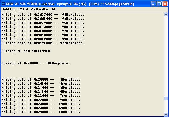

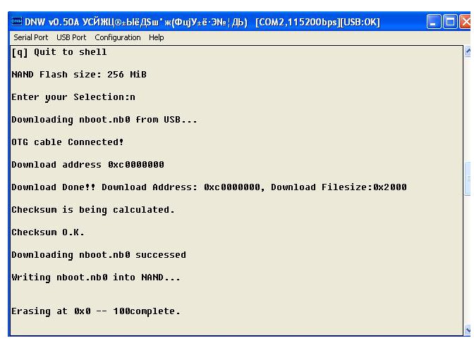

2.After that has chosen the command [n] Download Nboot.nb0 for WinCE,
and ported Nboot_A70.nb0 into nand.

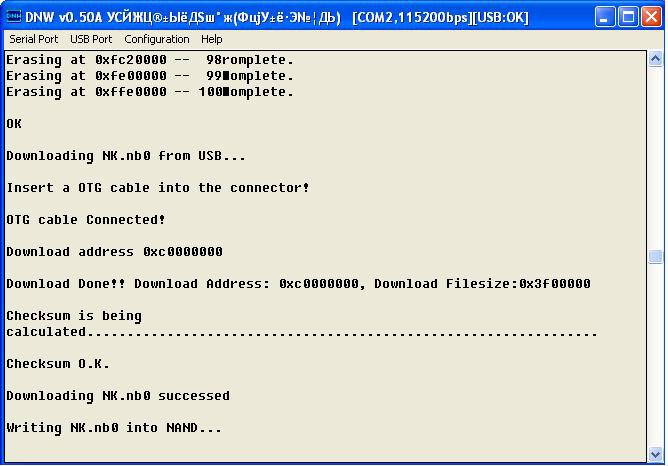

3.After that has chosen the command [w] Download WinCE NK.nb0,
and ported NK_A70.nb0 into nand.

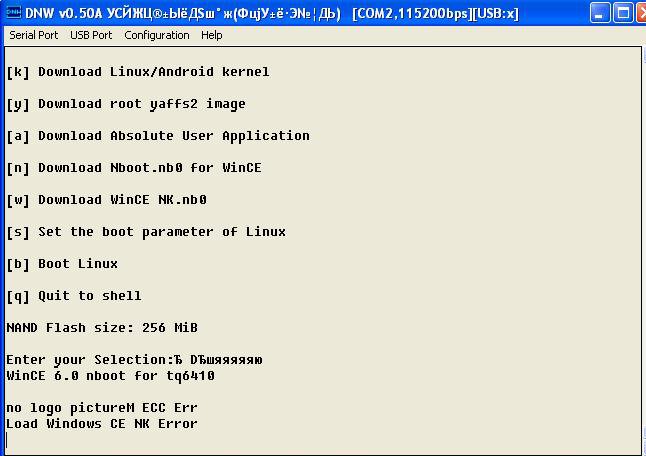

4.After all it I started from nand
That I should make. Help me
